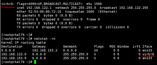

첨부된 캡쳐 화면 처럼 virbr0 인테퍼이스가 왜 있냐는 문의가 있으며, 이를 없애달라는 요청이 있습니다.

첨부파일 캡쳐.PNG 파일 참고

The virbr0 bridge interface is created by libvirtd's default network configuration. libvirtd is the service which provides a basis for the host to act as a hypervisor.
One could prevent libvirtd's default network from being activated on boot, or you could prevent libvirtd itself from activating on boot. The former will prevent any VM guest attached to libvirtd's default network from having network connectivity and the latter would prevent VMs from running at all.
